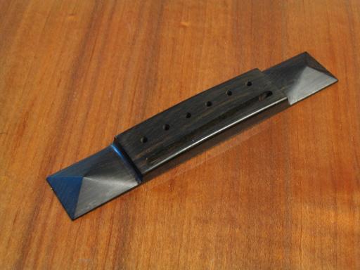

I recently made a pyramid bridge from african blackwood, rings like rosewood and looks a lot like ebony. Weighs 28g.
PaulB38965.9963657407

nice, Paul.

PostPosted: Tue Sep 05, 2006 3:16 pm
[QUOTE=Howard Klepper] nice, Paul.[/QUOTE]
Thanks Howard.
Frank Ford has to get a lot of the credit tho, he's got a pretty good demonstration on how to make them over at frets.com.
PostPosted: Tue Sep 05, 2006 10:10 pm
Posts: 720
Very cool bridge Paul !
CRAIG LAWRENCE of AUSTRALIA
